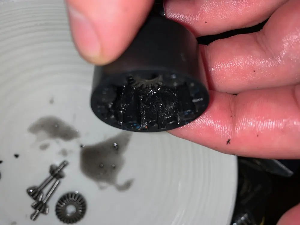

Hello all,
I just finished building my new EB48 2.0 and took it out for run today. After some light running for about 15 minutes I started getting abnormal noises and figured out that the center diff was slipping. I pulled it apart and found that the spider gears had starting eating into the plastic housing. There were chunks of plastic floating around in the oil, although all the metal gears seemed to be in good shape still. Has anyone else had issues with this? This is my first kit build. Could this be caused by too much oil in the diff? I'm working on getting a new housing (TKR9115), but I really don't want to repeat this. Any help is appreciated.

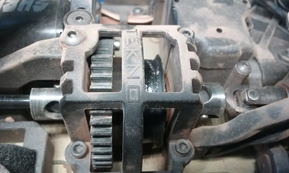

Sounds like you cooked your diff, what weight fluid were you using?
How many cells are you running and what is your gearing and motor can size/KV?
I am wondering if there was some burs on a spider gear that caused it to over heat? Spin an hobby knife inside the spider gears to clean up and burs. You want to make sure the spider gears can spin freely on the cross pins.
You can clearly see the circular pattern melted in the diff cup in your pic, that is what makes me think it had something to do with heat and that gear.
Thanks Bill and Tbuggy. I think I figured it out...this was my first run and before the diff issue came up the set screw which connects the driveshaft to the rear diff came loose. It took me a minute to figure out something was wrong. I guess during that time the center diff was spinning like crazy and must have heated up and melted the plastic housing. Lesson learned. Set screw has a ton of threadlock on it now.
Also to answer Bill’s questions, I’m running 10k fluid (stock) 4S @ 1900kV HobbyWing.

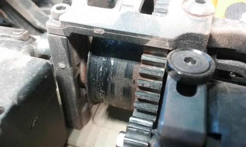

Just peaked inside mine. Oil is grey, so metal deposits, but no sign of breakage.
Oil level was lower than expected. Had 5 packs through it only.
You have melted the inside, and I melted the outside ? :ROFLMAO:...
...with a little help from Mother Earth coming onboard. It's just one of the risks I take running on ungroomed backyard track. Happened back on June 9th, but I'm still running the same diff case. I got a new one waiting for when the day comes. I just want to see how much torture this buggy can take.
