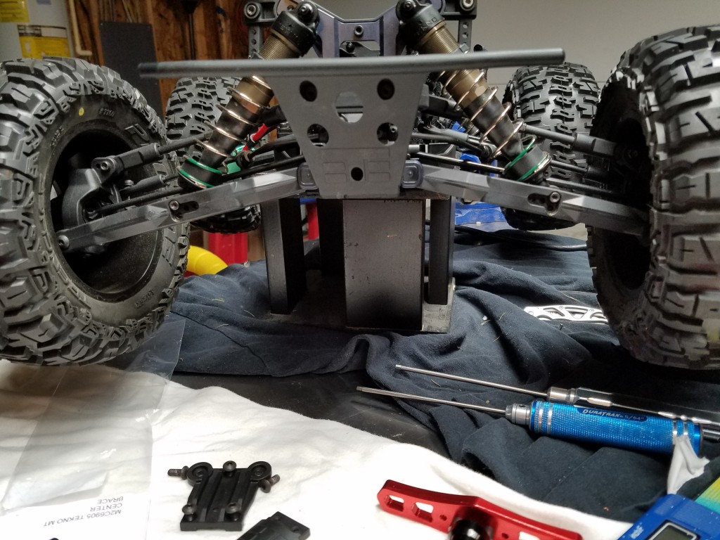

Same here, droop to limit steering knuckle from binding. I will add a pic tonight!

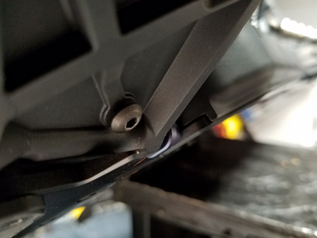

Here we are... it actually reduces droop quite a bit where I have it adjusted but it is very true that the steering knuckle makes contact if I go any lower! Not really a problem though!

@RC_User I see that you went with the button head down...

Button head always down to reduce wear on the droop stops on the chassis. I don't use the ones that come with the MT410. I upgrade to these from the ET/EB
https://www.teknorc.com/shop/tkr1238-droop-adjustment-screws-m4x10mm-8pcs/
yeah for those who are unaware, the ones that came with the MT410 aren't really "droop screws" but normal screws. the specific droop screws (like Pauly mentioned and that most 1/8 scale rigs come with) have hollow shafts with a 2mm hex insert on the bottom of the shaft so you can adjust them from above. Luckily there is a ton of easy clearance to adjust them from the bottom (button head) on this rig (not all rigs are like that) so there is no benefit to get the "real" droop screws for the MT/ET, other than satisfying the upgrade bug! Which we all LOVE to do!
After the kids were in bed, I decided to bust out the calipers and see what the droop was via shock length as the manual states/defines it and was waaay of. I didn't measure initial/actual but when I set the caliper to 115mm on the front, I was probably 5mm longer than that. So, I flipped the screw around to go button side down and adjusted it to the factory recommended droop of 115mm. The back was even further off and I am quite confident that contributed to the shaft breakage right where the piston rests. Im hoping that by having the shafts 5 to 6mm further into the shock body that this issue doesn't repeat.
