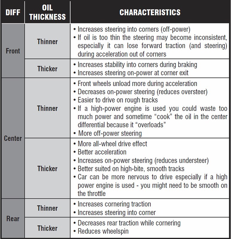

Per the Hudy Tuning Guide:
If you are bashing your ET I would suggest a higher weight fluid in at least the center diff.
The chart Bill posted is awesome. Definitely print it out or save it to your phone for reference when you go to your local track.
