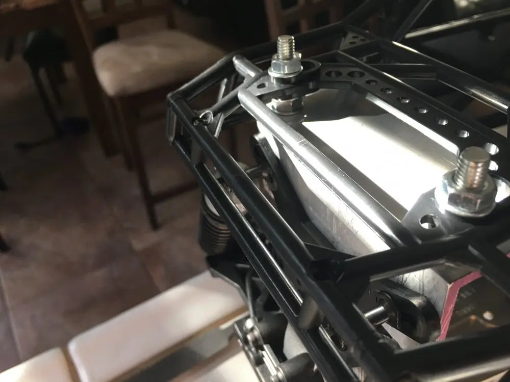

definitely interested in how you mount up the body. i used to own a wraith and love the caged body. no more wimpy lexan bodies to replace every few months, i would love to do this conversion just for the bash factor. definitely interested in seeing how you mount up the body.
I should start on the body posts soon. I can’t say I’m not just a little worried. Lol. I’m pretty sure I’ll figure it out. I am not sure on how good the cage will hold up in hard bashing. Well, at least to the way I drive my mt410. I’ll likely only use it to try my luck in the u4rc races. The panels get easier to make. The first one being the most difficult.

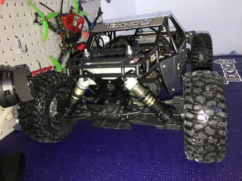

Here is a sneak peek at the back posts. I need to go to hardware store and grab some locking nuts.
No bud, I have looked everyday since I started the project. I will let you know as soon as I find one.
Thanks man. I'd appreciate it.:) Rear mount looks good

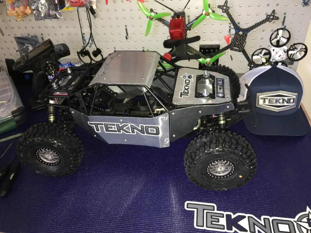

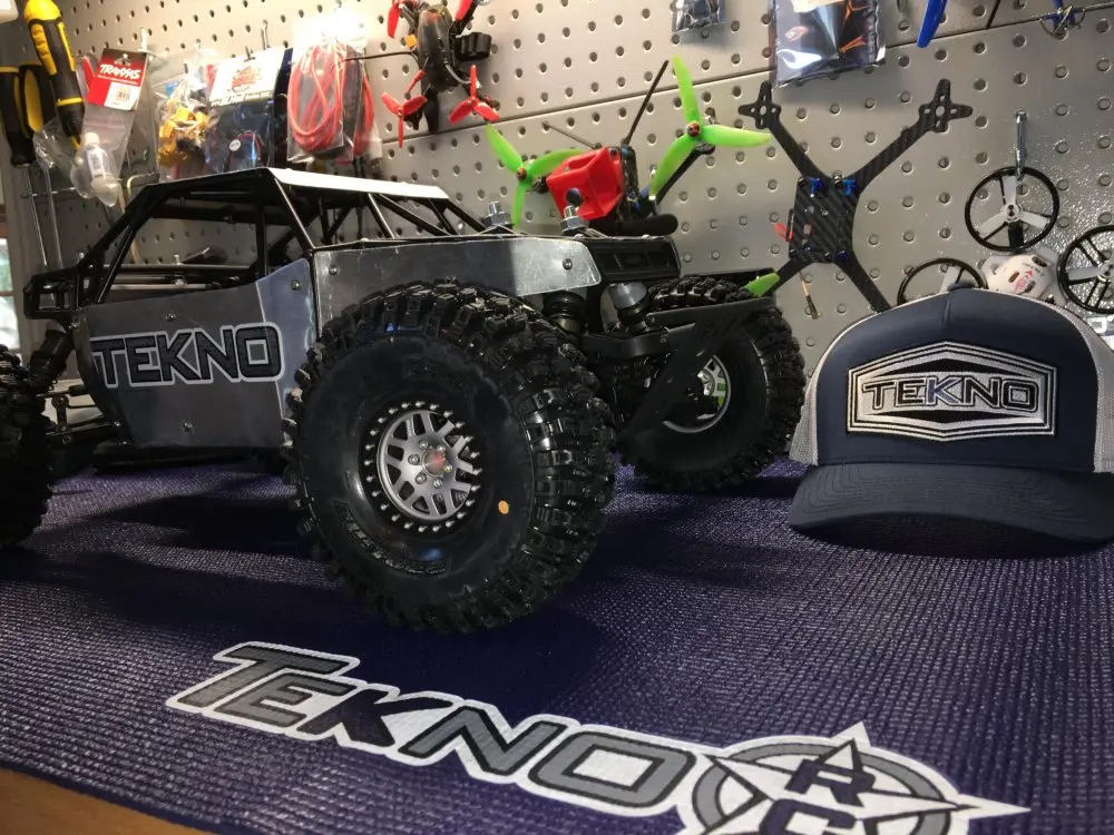

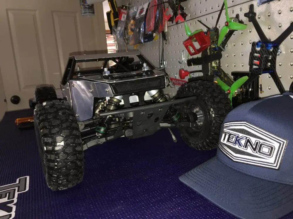

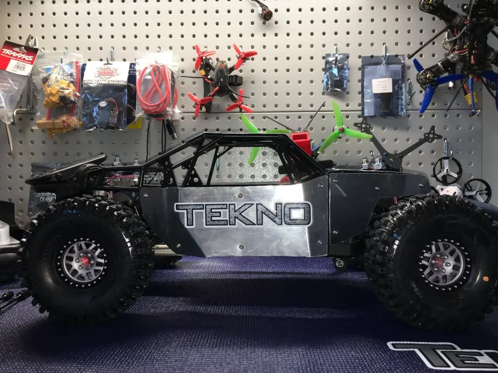

I am going to redo the fender panels. They were close enough for now.
I originally thought I wanted the cage to sit lower. Then I realized that the cage would bottom out before chassis. In the near future I will make the front posts more like the rear. At the moment I just want to drive it.

Came out good buddy(y) I need to get mine done this week. I typically don't work on the RC's during the weekend so the wife doesn't murder me:LOL: Have an alternative to the cockpit I'll post soon too;)
Thank you! I also bought the new b6.1 kit so I needed to finish this project to get started on the next. I’m going to take my db48 to the local track here. No rock racing, but they allow almost anything in the rookie class. I’m going to give it a shot. Should be fun either way.
I’m looking forward to your cockpit idea. At this point I’m not sure how long it will take for the nomad cockpit to come in.
