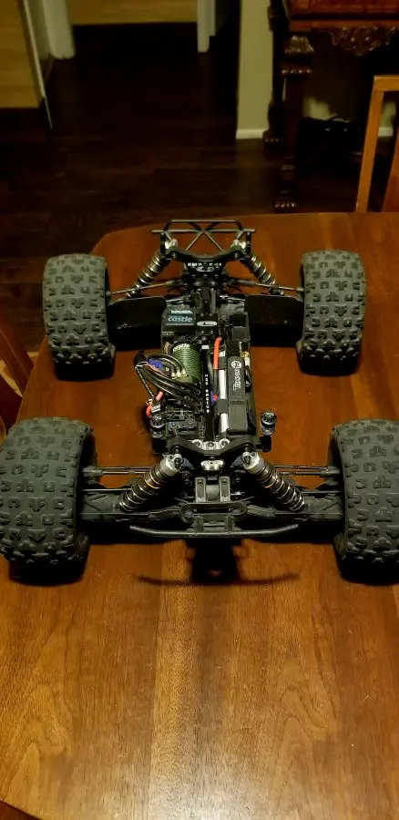

I did some research and liked the idea of building a kit so I decided to go with a MT410. My build:
Castle Monster X w/ 1515 Sensored 2200kv + Blink Bluetooth
Savox SV-1270tg
Tekno 25t alloy servo horn
Proline MX38 Badlands
T-Bone bumpers/ skid plate/mud guards (Go with the stunt rear and buy the extra wheels)
M2C Rear brace kit
M2C Alloy center diff
Traxxas transmitter/receiver (i had spares from the slash)
Dusty motors M+ cover (that one may be a bit too long)
SMC 6500mAh 4S
Robinson 15T Hardened pinion
44t Hardened spur
Some other bits and pieces

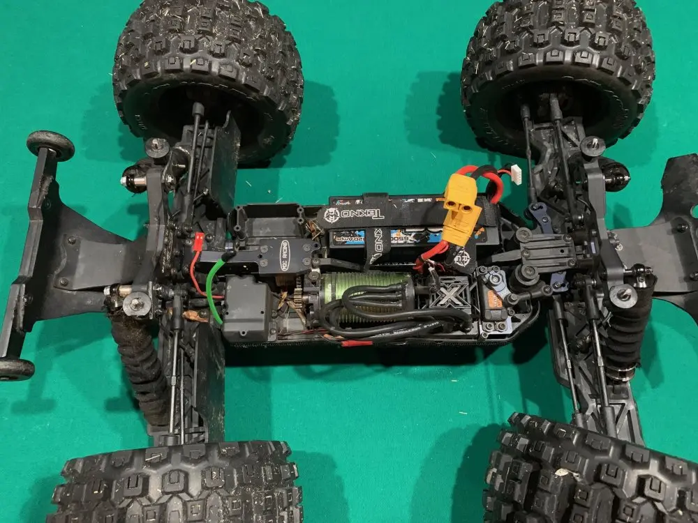

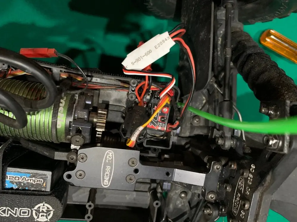

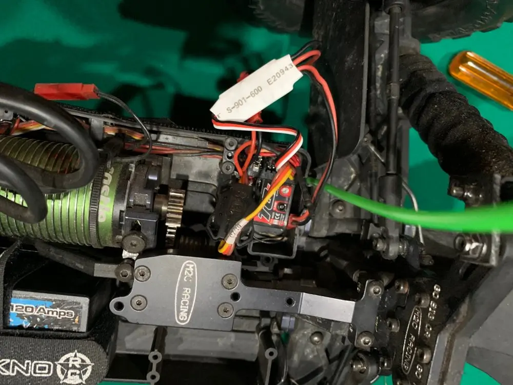

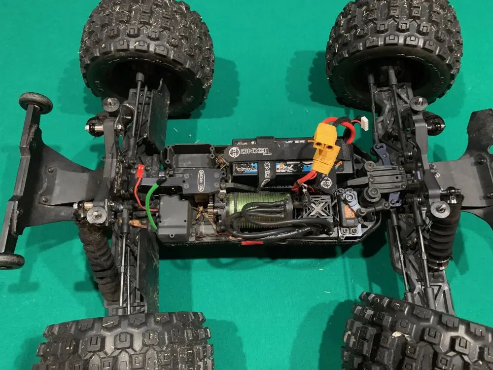

The thing is a beast and delivers back flips on demand so, for me, 4S is all I'll ever need. The tires balloon so much now that I can't imagine what 6S would do.
Nothing too out of the ordinary. I mounted the ESC in that position to avoid crossing the motor and battery wires. The harness wires tucked nicely under and looked clean. I added some wires to the esc battery connector to drive lights. I could have pulled the power from the receiver and the esc's bec but I think that isolating them is a better option. I managed to pack the receiver, blink module, light controller and traxxas temp and charge telemetry into the receiver box. It's a tight fit but keeps them out of harm's way. I do most of my runs at night so lights were a must. The controller is on channel 3 so a flip of a rocker switch on the transmitter turns on/off the lights.

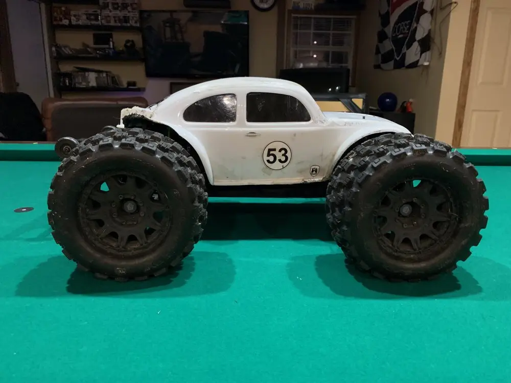

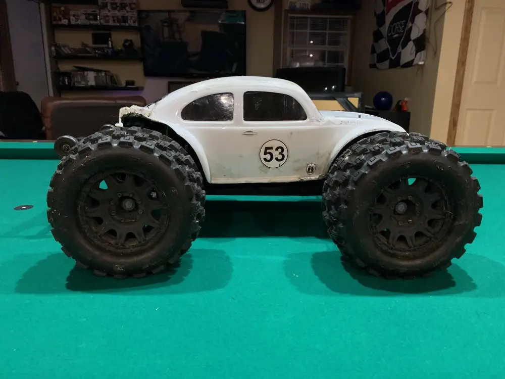

I had a couple of baja bodies left over from the Slash monster tire days and I really like that look so was pleasantly surprised when those bodies fit.
That's what I'm shooting for. A Herbie the Love Bug look except with attitude.

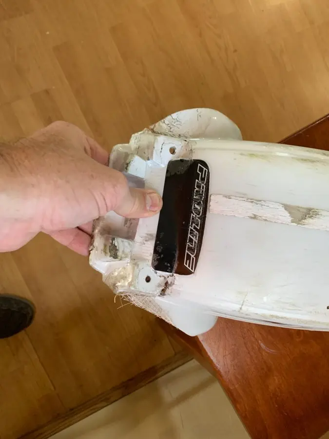

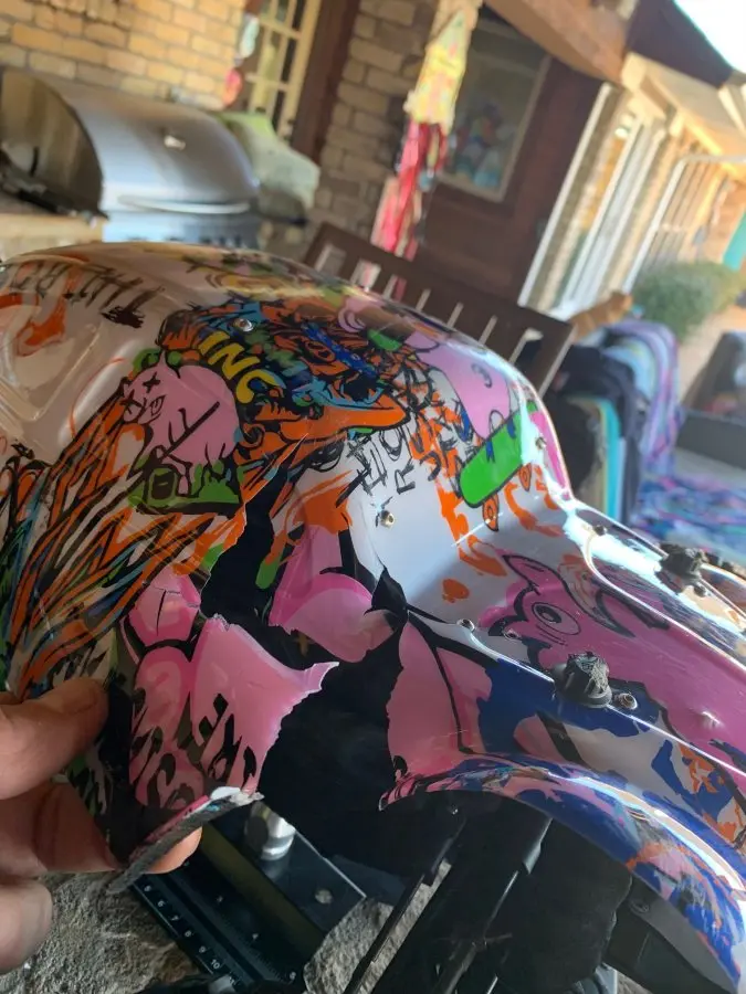

And that's when the problems started. I never really did trash a body with the slash since I reinforced them all with ShoeGoo and drywall tape but this truck is something different. For some strange reason, the bodies don't like a 10 foot turtle landing (accidents happen).
It was failing at the a pillars as well. Also the rear fenders were catching on the grass so they were failing as well
You can see in that pic how the fender folded over and it's tearing where it meets the body. When I looked at the damage, the drywall tape was failing. The ShoeGoo held, but the tape tore.

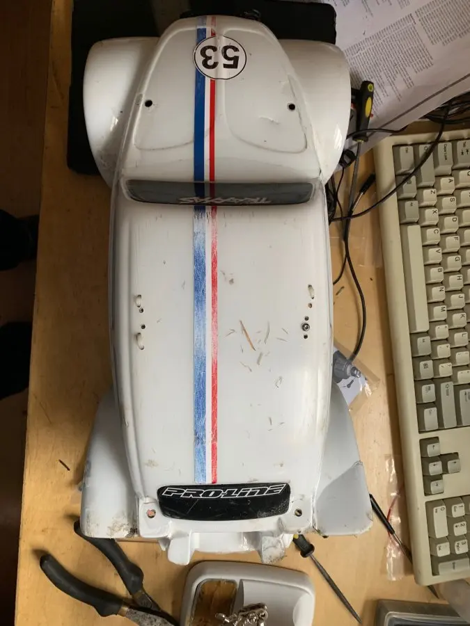

I built up the a pillars and they seem to hold now
But that trick isn't going to work on the back.

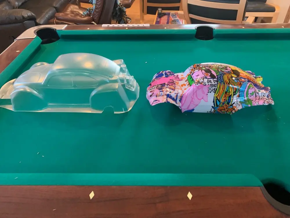

I bought a cheapo Graffiti pig body off ebay to test with (slash parts are *easy* to find) and a Proline baja from the LHS for when I get something workable.

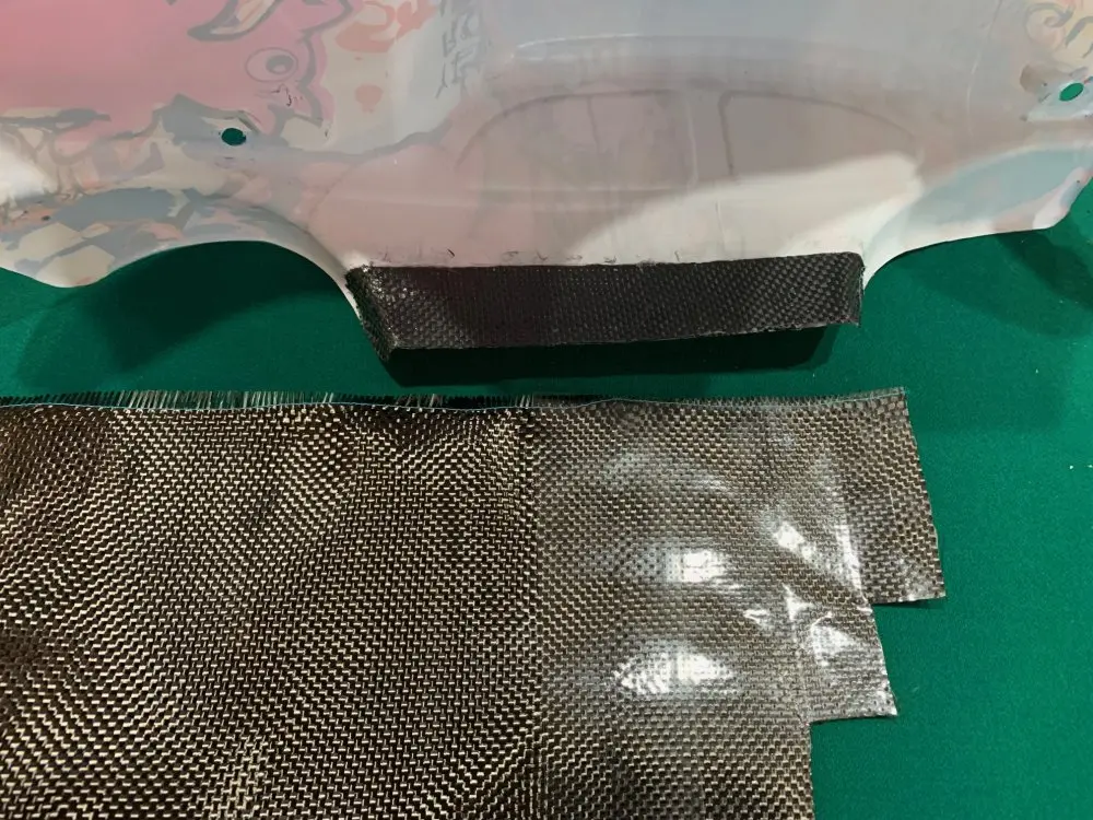

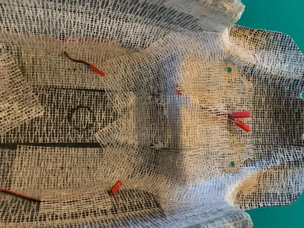

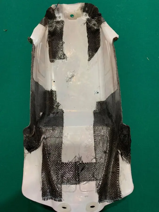

It seemed to me that the drywall tape wasn't cutting it anymore. It was there for tear resistance and it was failing. To address that I'm trying ShoeGooCF:
That's carbon fiber cloth from Banggood attached with ShoeGoo. That should never tear (i hope). To keep it from unraveling, I'm using packing tape on top to hold it together while the ShoeGoo underneath dries. That's working out ok and peels right off.
What do you think? Am I going a bit too far? I plan on layering that at all the stress points.

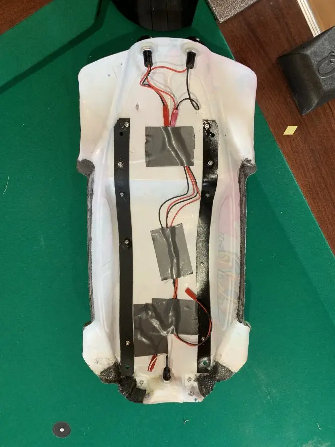

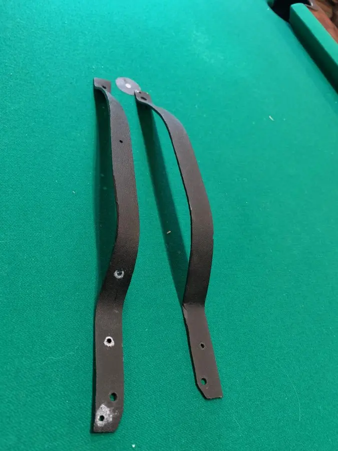

To take care of the roof landings, I'm going to try mechanically attaching Kydex strips to the underside of the body from mount post to mount post. I made a wood pattern:
I've got some 0.093 Kydex coming so my plan is to cut it into strips, heat it in an old oven that I use for powdercoat and then mold it. Once molded, attach it to the body with screws so when it lands on it's roof, it'll have to deform the Kydex as well as the body. Hopefully that will be sufficient to protect it. I've never worked with Kydex so I have no idea if it will work. Anyone got any tips?

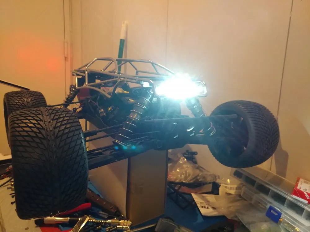

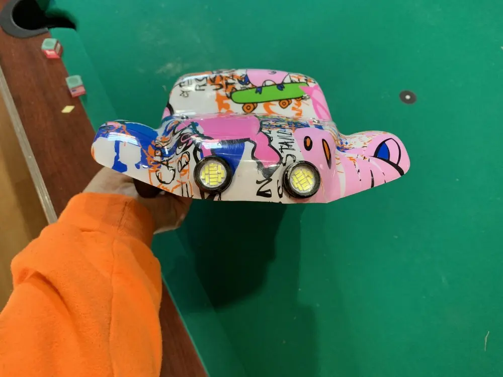

The lights? Well running the slash taught me that lights on bumpers just don't last. If they can make first contact with something, they will not last long. I tried a bunch of different ones and none lasted for more than a week of bashing. Commercial products or ebay sellers, it didn't matter.
That's why I'm going with body mounted lights now. They seem to be out of harm's way.
I'm using these:

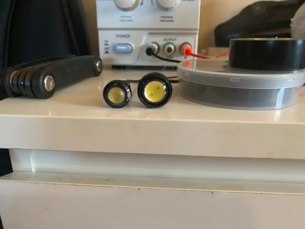

Those are 12v COB (chip on board) LEDs in a metal housing built for cars/motorcycles. There are a couple of different styles and sizes. Here's the other style and size:
The small one is a 18mm the large a 23mm.
These things are bright
The red is so bright I felt the need to smoke them with Liquid tape (it dries translucent) to be easier on mine and the dog's eyes.
I only run one red because you don't need two and I'm not trying to be scale.

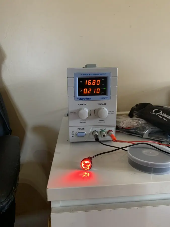

Even though they are listed as 12v they work at a range of voltages. They'll do 2s to 5s straight from the battery but the more volts, the more bright but the more heat which means the less life. I've been running a set for three weeks now on 4s voltage just fine. I'm probably going to end up using a Banggood 12v bec to try to prolong them and the 16v that a fully charged 4s gives is a bit too bright.
Here's a red one with liquid tape at full 4s:
Notice how many amps it's drawing. at 16.8 it's .2, at 12v it's only .075 amps and at 9v it's .02

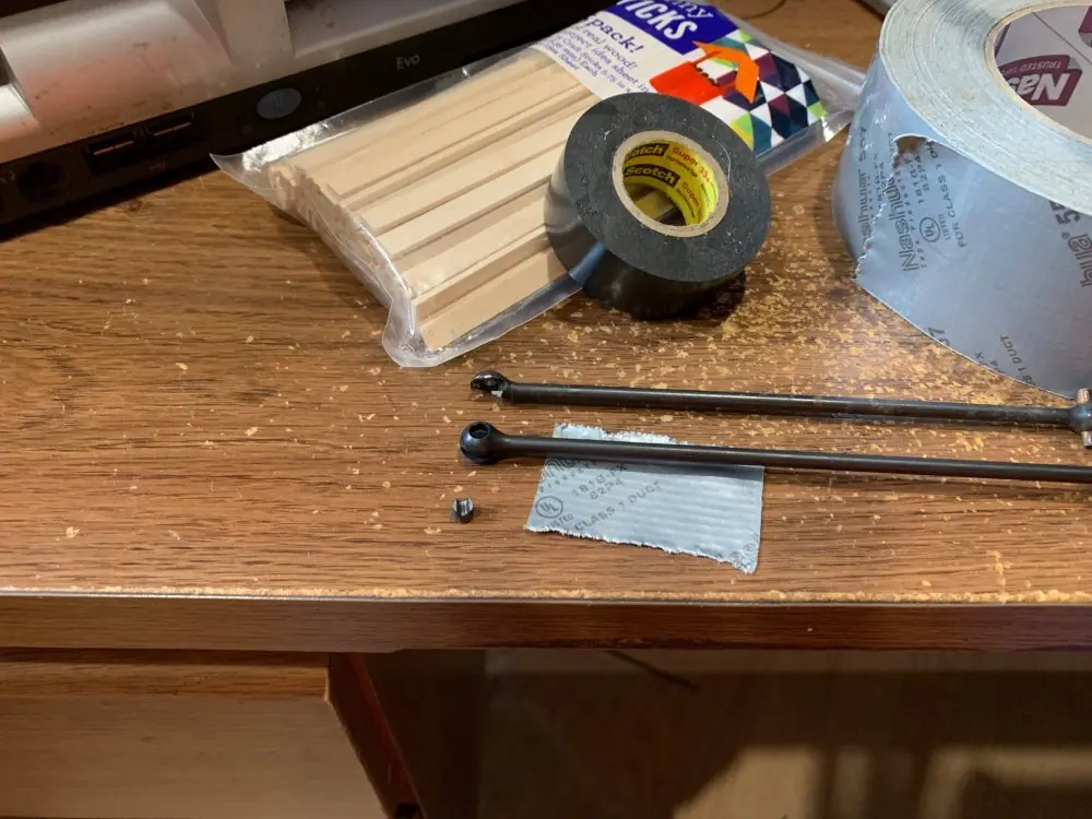

On the downside, they are huge. All that weight has to be stressing the suspension. I've broken two rear driveshafts so far. They broke at the wheel hub (the shaft was fine):
which I hear is unusual. That time it even broke the retainer inside the hub. Maybe I need to adjust the control arm stops a bit more?

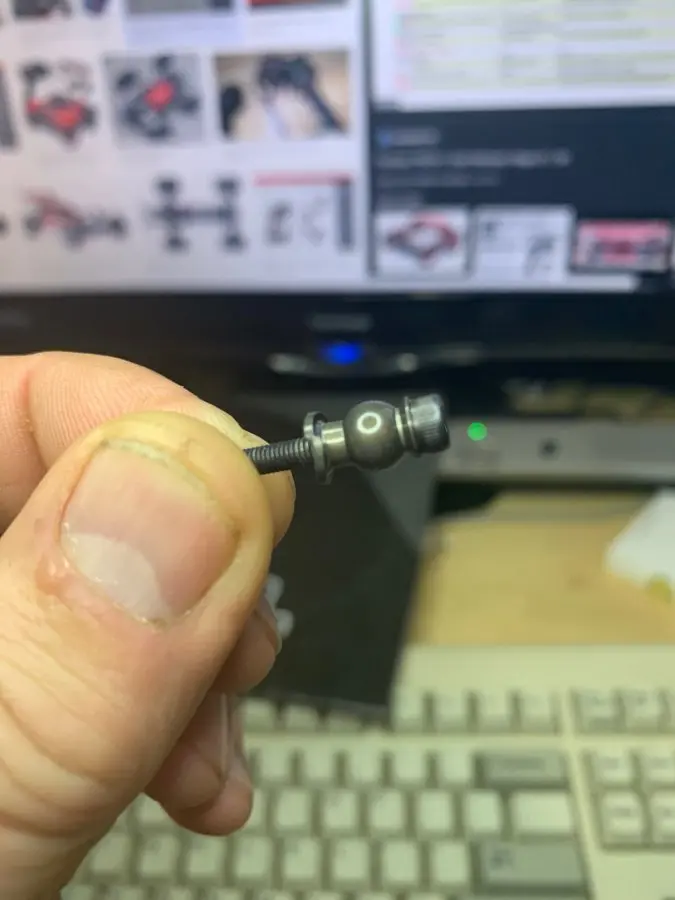

And I've bent two rear turnbuckle standoffs:
You can't see it but the screw is bent and can't be removed. Aluminum ones may be great for racing but I would love for them to start making the steel ones again.

I think that the driveshafts are my fault for landing while on full power. I guess the standoffs are my fault as well for landing skewed but I think that they could be a bit tougher.
I misspoke when I said that it broke in the hub. They broke inside the stub axle.

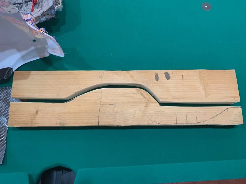

The Kydex came on the 23rd and I played with it on the 24th. The .093 isn't very stiff so I'm afriad that I'm going to have to find some .125. There's plenty at 12" x 12" but I need 16".
The wooden mold was a bust. I had the shape generally correct but it didn't have the correct contours to hug the body. I did 5 ramp hits with the molded ones and I could see that it wasn't going to work.
Instead I cut some new strips, heated them for 90 seconds at 300 and then molded them directly on the body. I was a bit worried that the heat would damage the lexan but my worries were unfounded. Here's a shot of the wood molded one vs. the direct body molded one:
You can see how the one on the left has a bit of curve at the top. Those worked out much better so the mold went into the fire pit.
I could attach the new ones to the body with screws and that made things much stiffer.

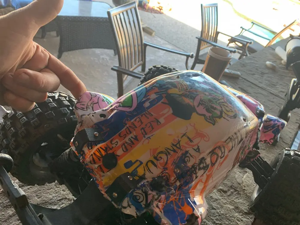

I launched it off the ramp about 25 times letting it land as it may. The rear fender caught and caused a stress mark or two but no real damage. Was pretty pleased at that point but then I took it to the backyard and my little flipping mound. (You can see the mound in the picture showing the strength of the lights) I was trying to get a triple off that when it landed on it's left rear corner, pulled that body mount out and twisted the body in the mid right front.
Total failure. Oh and you can also see that perhaps I have the front a bit too low since the shock mounts are damaging the body.
I figure that this is my chance to see how well ShoeGooCF works. If it can fix that damage it's worth keeping:
Here's what I have now. I did the non-damaged side as a precaution. I had some screw heads pull through the body so I'm waiting on some washers before I can assemble again. I should be hitting the ramp again tonight.
I've pretty much removed the bulk of the rear fenders and the motor piece.
