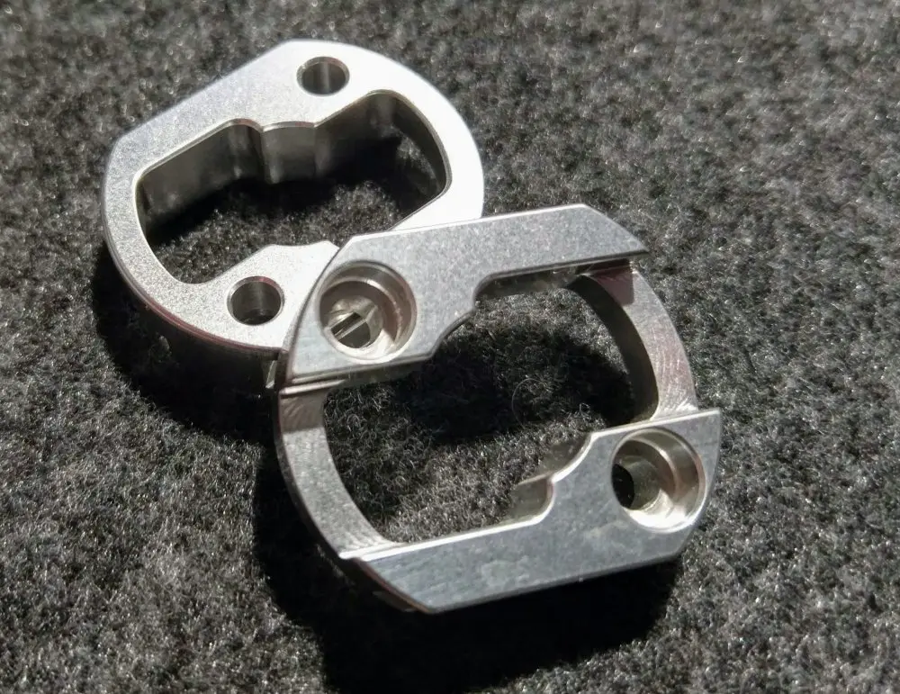

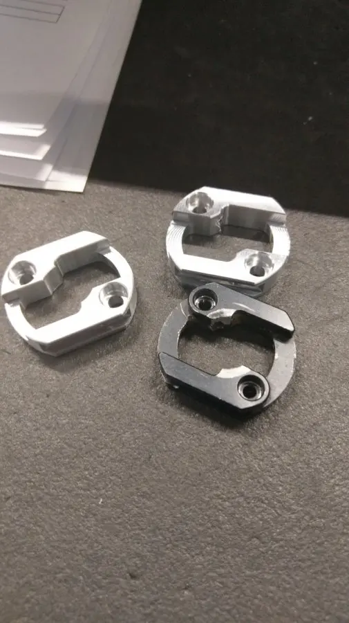

Hey folks,
I thought i share my current project im working on.
I stripped my thread in my Insert last weekend.
So I made a new one and changed the M3 mounting holes to fit an M4 Screw.
Made of 7075 t6 as always.
Nice but you should trim them on the side in order to slide them closer to the spur to allow the use of smaller pinion for the big tires users.
You are limited to slide closer, because the Motor will hit the chassisbrace first, and if you use bigger wheels you should use a proper Motor imo .
