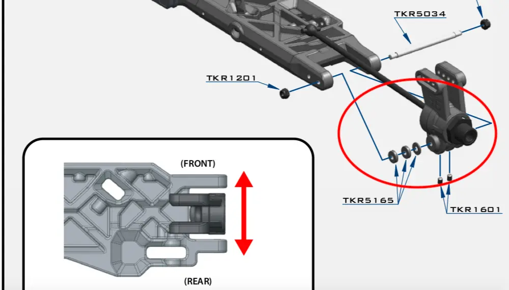

Two things are unclear to me after reading the manual, pre-build:
[GALLERY=media, 109][/GALLERY]
More sweep uh? Is that more front, more rear, doesn't matter, what's the setup for centered anyway?

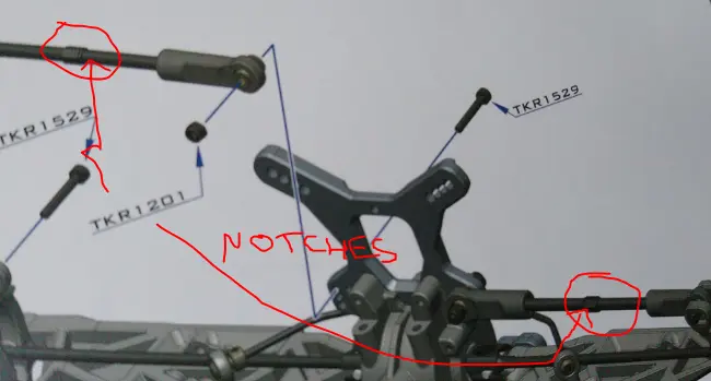

Goddman socialists, confusing the hell out of me. Picture appears to show the little indentation torward the center of the car, but it says "the left". I'm lost.

As for indentation, pretend you are sitting in the vehicle. You want them on the left side no matter if the turn buckles are on the right or left side of the vehicle.

Adjusting more sweep would be making the dog bones angled back more (towards the rear) than forward.

OK So stock is centered, and swapping (some or all) washers to the other side will add sweep.
Ok, got it. I have at least one vehicle where stock is strongly angled torward the front, so it's not obvious to me, I haven't built a kit in close to 25 years.

Well duh, but the drawing of the drivetrain shows both notches on the center side (so left one is on the right, right one is pointing left), hence the confusion. I'm going to assume the drawing is wrong.

Yes switching those spacers around changes wheel base and sweep.
In the case of the drawing, its probably wrong then.
The idea of the notches is so when making the adjustments on the completed build, you turn the wrench in the same direction on all of the turnbuckles to make the same adjustment.
Going by memory if you set it up the way Tekno states (not pictured), you can turn your turnbuckle wrench towards the the rear and it makes positive camber adjustments. Turning it towards the front does negative camber adjustments, or vice versa just going by memory.
