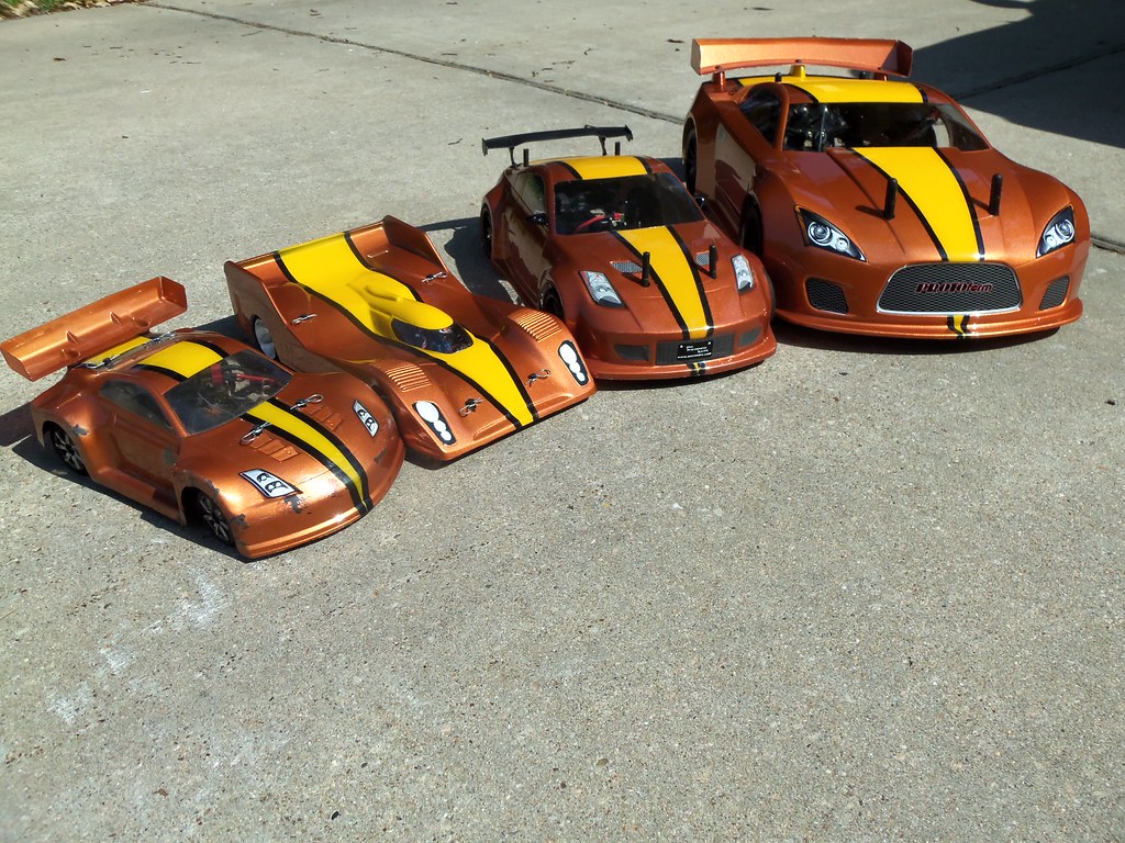

Here is a conversion I did with an Associated RC8 buggy many years ago, which uses roughly the same size shock towers as the SCT410:
Thanks :)
I actually started with these racing colors with my on-road classes, then over time I slowly migrated toward the off-road classes too and kept the same theme, folks always know who I am on the track :)
From left to right in pic:
Associated SC18
Associated 12r5
Nanda NRX-10
Associated RC8
