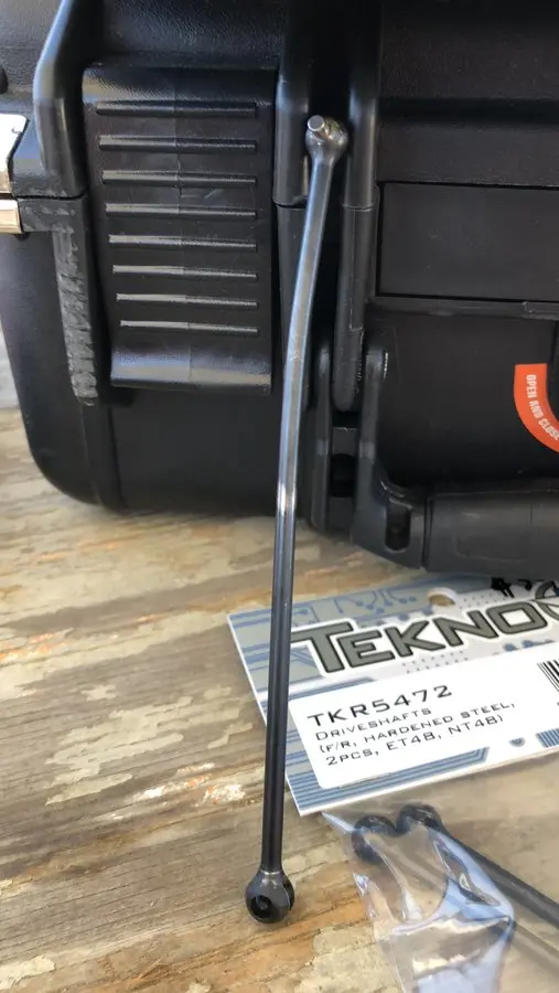

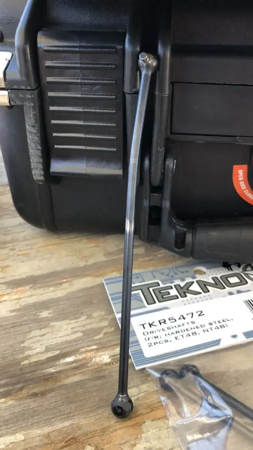

I haven’t broken a shaft per se, but I have bent 2 of them so far on the track. This one is the worst one so far. Luckily the lhs at the track carries tekno parts so I was able to replace in the pits and get back out there. 50221BF0-4A2A-4778-82E1-0FE5EB8263DA.jpeg

I haven’t broken a shaft per se, but I have bent 2 of them so far on the track. This one is the worst one so far. Luckily the lhs at the track carries tekno parts so I was able to replace in the pits and get back out there. View attachment 892
Ever tried to bend them back?
