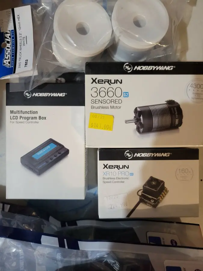

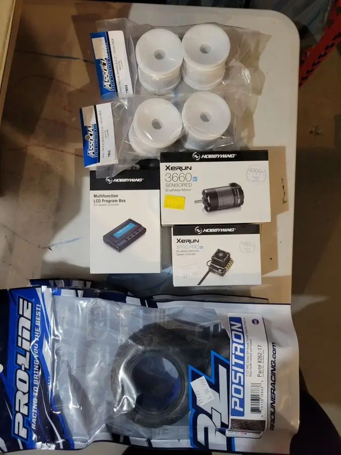

I just went to my local hobby shop and picked up some wheels, proline positrons, a hobbywing XR10 Pro 160amp, and a 4300kv motor. Any recommendations for what pinion to start with? It is a small track with technical sections and tight turns.
With the motor you have and a small technical track I would probably start with a 15T pinion. If you can swing a couple extra bucks I would have a 16 and 17 to experiment with and to have if the track lay out changes and opens up.
