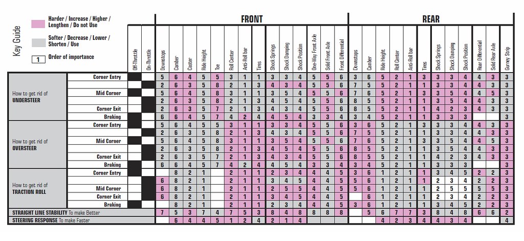

It's really hard to say what will be the best for you without actually seeing what is happening, if you can get someone to record a few laps and then post a video of it, then maybe I can help make a few suggestions. Shocks alone won't address everything, but yes tires will solve 50% of your issues first, then everything else will account for the other 50% of tuning. Mixing surface types can be nearly impossible to solve, you will have to make a trade off and decide which section of track is costing you more time, then tune for that section as your priority.
I would read this doc first:
https://www.teknorc.com/wp-content/uploads/2014/06/Set_Up_Guide.pdf
Then use the guide to make changes based on priority of what you need:
