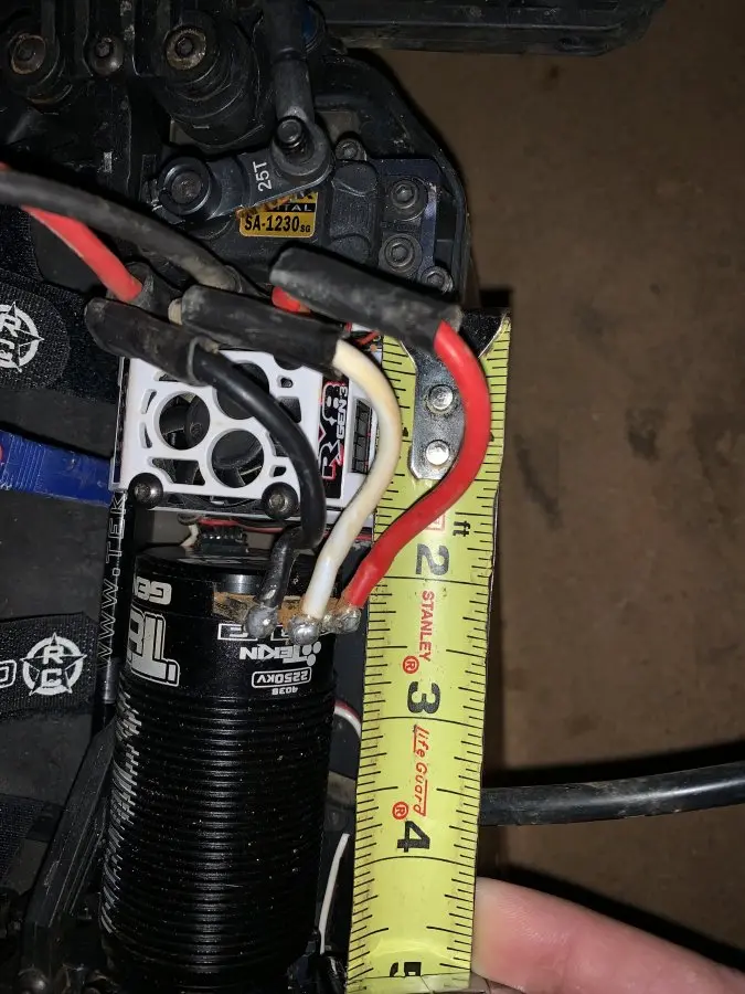

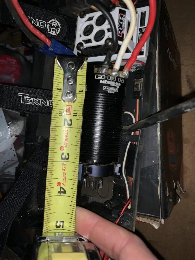

Can you measure your motor can? Ignore the shaft that the pinion sits on and just measure the black can.
I have just under 2 inches of space between the motor and the servo.

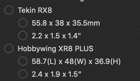

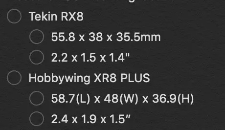

Looking at the measurements in the specs, this is what he was seeing. I have just barely under 2" in width for the ESC mounting location. And the Hobbywing XR8 Plus is 1.9" wide. So that's the super tiny wiggle room you can see in Mark Santa Maria's video. In your post with your Buggy, yours looks snug too, but not that snug. Is your motor can smaller than mine?
Yes it looks like you are running the 4038 (which is typical for truggy). I have the 4030 in my buggy. Its a good 8mm smaller.
