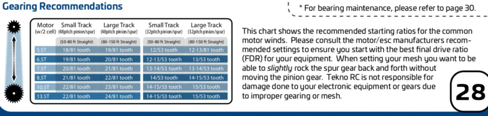

What gearing would be good for a 13.3 hobbywing motor? The standard 81. The optional 70. Or the Exotek 72?
Its all track type/style, motor and driving style dependent.
Use this chart for starting out and change pinions based on motor temps and track needs.

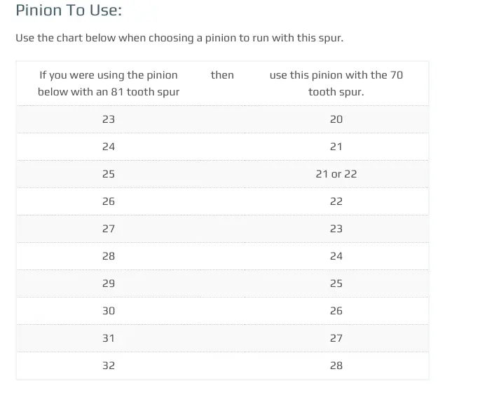

and here is a conversion chart for the 70t spur
