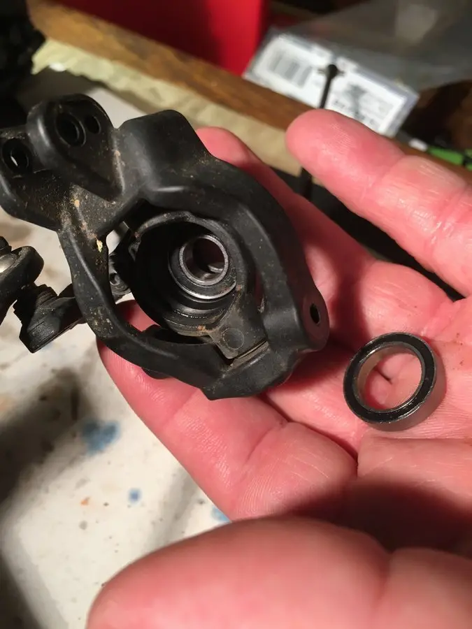

Now the extra 16x8x5 bearings just goes in the backside of the hub
I didn’t push the new bearings in far enough. Fits good a little more noisy turning by hand. Definitely can’t bind. Side by side they look a little thicker not much, enough to notice.
