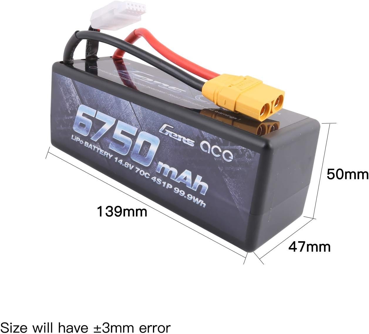

Assuming this battery will fit OK??
6750mAh 70C XT90

@Ifti
Discounted at the moment..👍🏼
https://www.gensacearespammers.de/gens-ace-5800mah-14-8v-50c-4s1p-hardcase-lipo-battery-14.html
Only thing I see a problem with those batteries is that the center strap on the battery tray will pull down tight on the balance leads..🤔
Good point about the battery strap and balance lead, I hadn't thought of that!!
Could always cut a small strip in the battery strap for the balance lead to poke through I guess?.....
Think I'll wait for the buggy to arrive and take it from there.......hmmmm.......

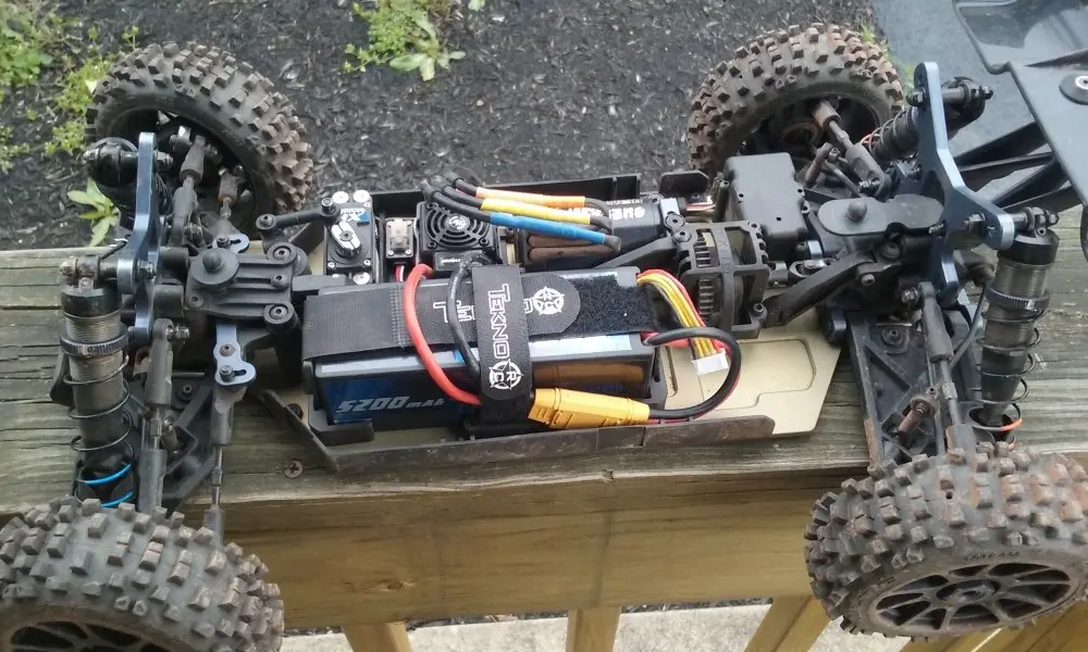

I went a second battery strap to hold down main battery leads. In the picture, you can see where I was concerned about the balance leads as well ;). I was going to go with the older Tekno narrower straps, but ultimately notched out a section on the new wide strap so as not to pinch the wires. And no, the balance lead does not flop around... sandwiched in between main battery leads.
