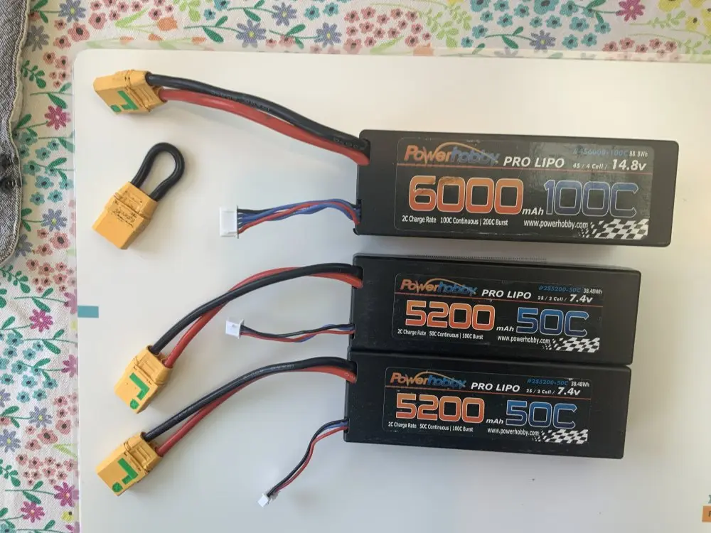

Since you're just bashing i would go for lower cost batteries. those power hobby 50c would probably do the trick just fine. In general my advice is if a battery gets really warm but the motor and esc aren't, consider going up in C rating or a higher end battery brand. 50c is considered low but probably fine for 4s if you aren't pushing it hard.
I bash and race with 20c batteries who do just fine. Their lifetime is not even bad (pretty much the opposite). 20c x 5000mAh = 100A peak current, if I’m not mistaken. Multiply by 14V, it is plenty of power if you ask me.
The beauty of 4s, there is enough voltage to play with.
