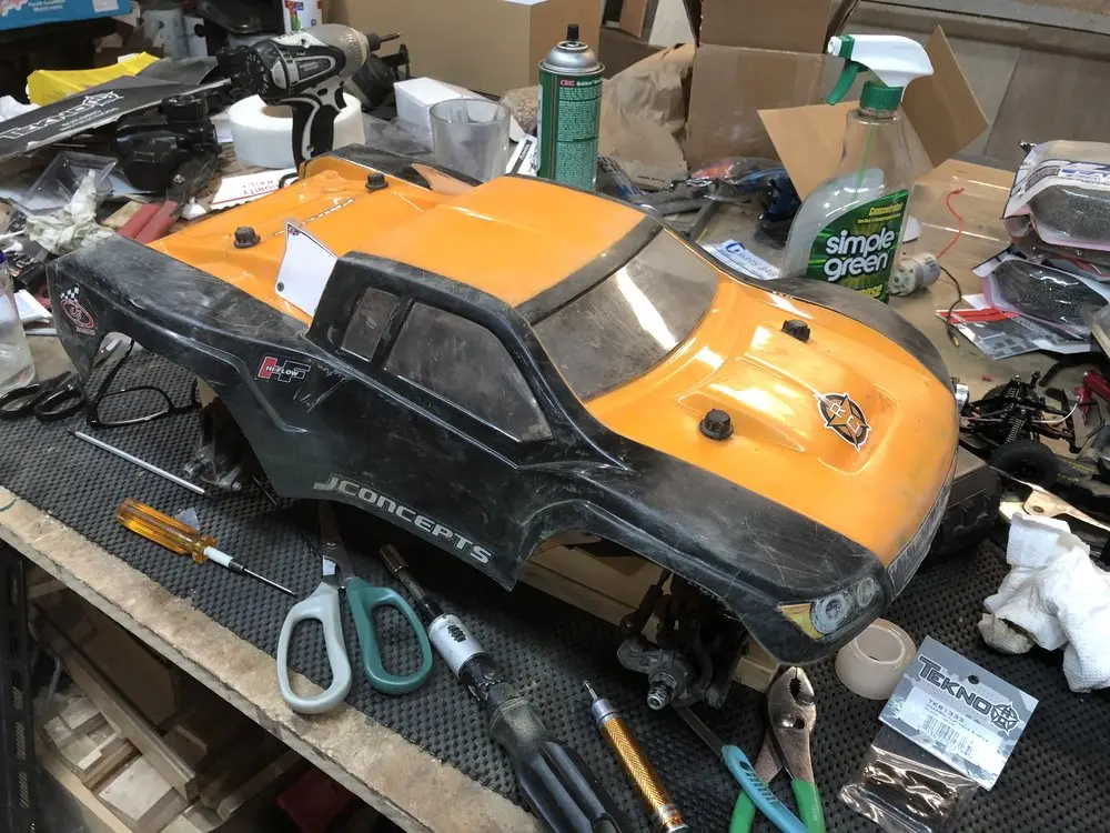

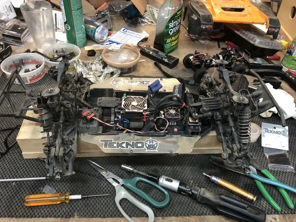

I am running the complete body mount system from an scte on my 410.3. They used to make a set for the teknos but its discontinued. The scte system has round body posts so it fits perfect in the 410.3 with not cutting or drilling. I have the old discontinued set on my mt410. I'll post some pics later but here is the proline part number. (Proline 6305-00) look it up under that name. The slash kit has to be highly modified btw.
