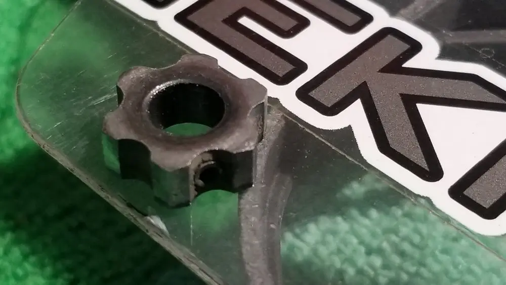

So I grabbed 3 sets of DE wheels for the sct410 a couple weeks ago and glued up the tires, and at the track today I was gonna try a set out and I've found that the hex is just a tiny bit too small to fit over the "12mm" lightened hub that comes stock on the 410.3. My proline, duratrax, axial wheels all fit, snugly but that's preferred. I think I might be able to pound them on but dont want to do that. Wondering if I should try some of the more standard 12mm hubs?
In this picture I had pressed as hard as possible just to get it this far...

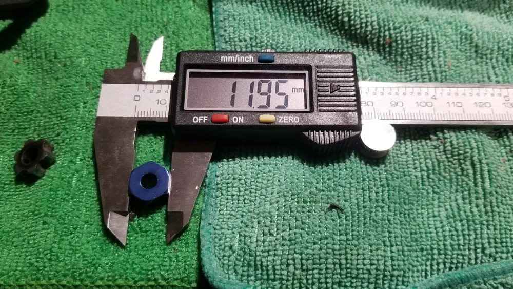

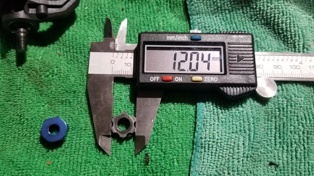

Measured some ST Racing hexes and compared to the Tekno lightened hex's. The ST's fit perfectly, but the axle hole is smaller so they dont fit...

For your situation, I would just hit the hexes with a file to shave off that 0.04mm and call it a day ;)
That's the plan, just wanted to see if others have had the same problem. Thanks!
