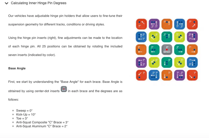

Finally got the MT410 yesterday . . . am at bag E and having a hell of a time figuring out what insert (TKR5163) to use on the rear end C and D block. Can't find one specific that's recommended. I can follow instructions but am stomped here. I'll keep looking for youtube videos on this and I'll come back here in a few. Hoping somebody knows what am talking about cause I don't know what insert to use.
TY bros~!
I get it, use the one dot and continue. After running it try different offset if necessary or desired. Seems you can adjust this 43 different ways or more. All stock one dot.
The one with the Hole in the middle. That's the stock one.
This is off of TeknoRC.com

It may help you when wanting to make adjustments in the future. They have a few build tips on their site that I recommend everyone looking through if they haven't.
https://www.teknorc.com/vehicle-setup-adjustments-and-build-tips/
