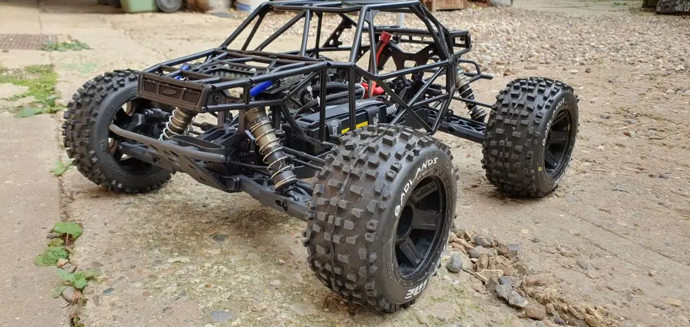

The cage is off a nomad. Had to make my own little plates for the body posts but fits perfect...even on the normal chassis.
