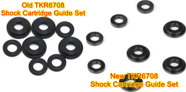

Spacers do look a bit thicker on the new pictures of that TKR6708 part number....
During the SCT410SL shock build, I had a chance to measure the shock cartridge guild set...
I'll measure the shock cartridge guide set in my ET410 when I have it torn down for maintenance.
