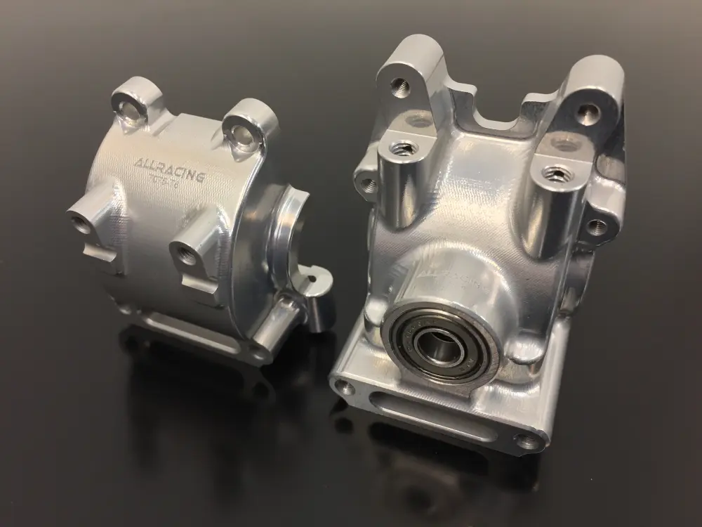

Big thanks to AllRacing for making these 7075 aluminum gearboxes, beautiful machine work!

Sleeves are included.
2346

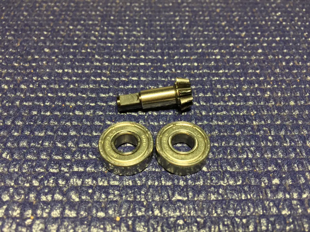

The rear gearbox uses 6x15x5 bearings with the sleeve, or 5x15x5 without. The front gearbox uses 5x13x4 and 6x12x4 bearings with the sleeve, or 5x13x4 and 5x12x4 without. All of the above bearing sizes are available from Boca Bearings.

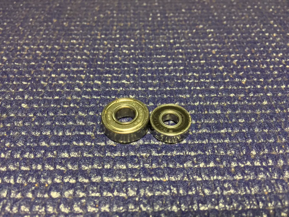

6x15x5 vs stock 5x13x4.

It is awesome that these gearboxes use larger outer diameter bearings.
However, I don't quite understand the benefit of 6mm inner diameter bearings (and then using the sleeve to take up the 1mm difference). With the 5mm inner diameter, the actual ball bearings are larger. I would have thought that was better, but maybe I am wrong.
In terms of durability, which bearing is better: 5x15x5 or 6x15x5?
I’m not sure, perhaps because 6x15x5 is easier and cheaper to find (Avid, Amain, etc). I ordered some 5x15x5, 5x13x4, and 5x12x4 rubber shield bearings from Boca. The 5mm ID should be a “better” bearing.

They come with larger pinion bearings. The stock bearings are 5x13x4 in the rear and 5x11x4 in the front.

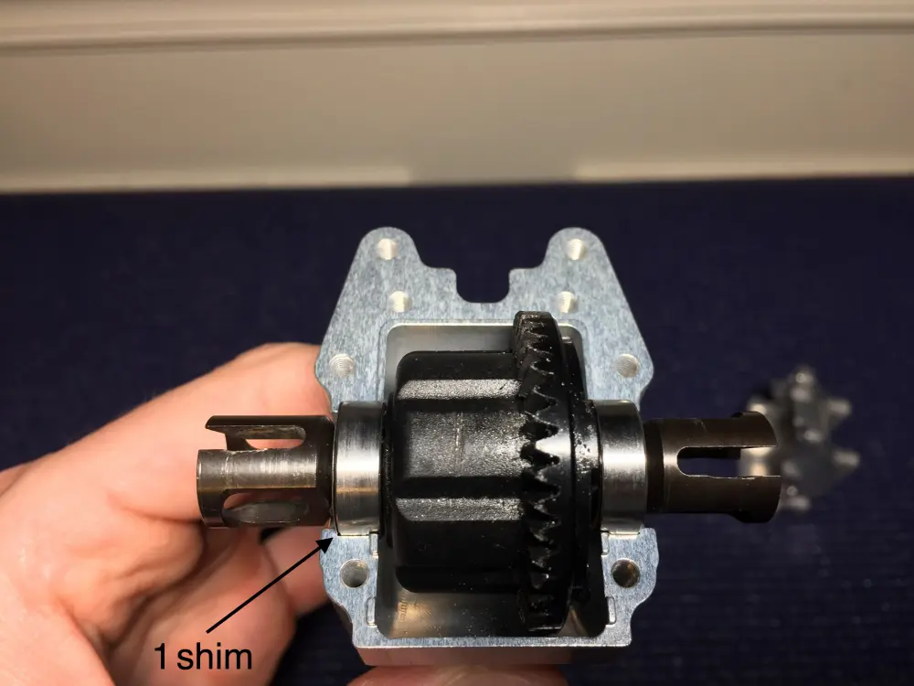

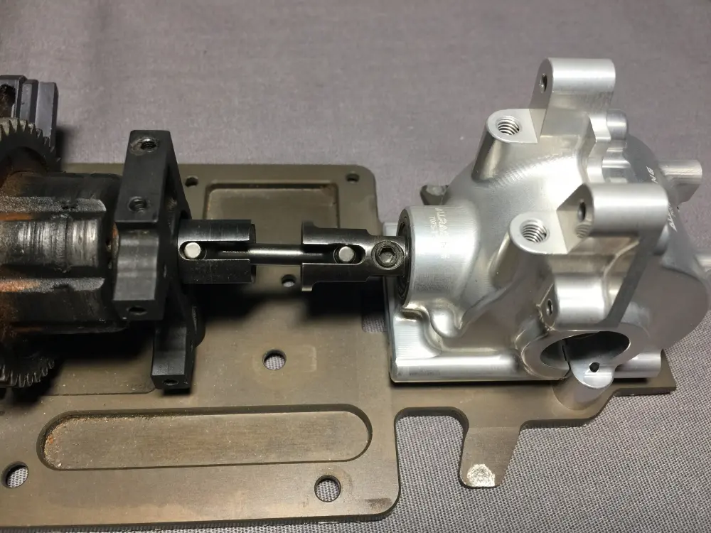

I'll be installing this on my ET, but I did some test fitting with the short MT chassis. I’m concerned about MT owners bending their driveshaft. This will not be an issue for ET owners using the 3mm shorter Arrma driveshaft because it gives you an extra 3mm of free play. Since AllRacing decided to use 5mm width bearings in the rear gearbox versus the 4mm stock width, there’s a total of 2mm of lost free play in the driveshaft front to rear movement. Which is ALL of it, there is literally ZERO free play. This free play is important during chassis flex so you don’t bend the driveshaft. The front gearbox is not affected by this because the bearing width remains the same.
I notified AllRacing about this and they said they were going to make some adjustments to the gearbox.

Will it be a problem for ET owners who using the stock rear driveshaft?
For MT owners, the only way I see fixing this would be to have a shorter driveshaft made or re-machine the gearbox bearing width to 4mm. However, using a 4mm width bearing really limits the size choices, 5mm width has a TON of choices. I really like being able to use a 5x15x5 bearing, it's much bigger than stock. Maybe it would be best to leave the bearing sizes alone and just make a shorter driveshaft for the MT guys.
