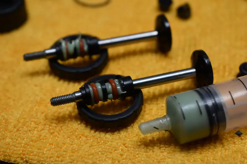

Help,410.3 shocks wont rebound equally. Rebuilt Orings twice still the same outcome one longer than the other WTD???

several things can be at play here...
you may not be using adequate grease on the o-rings when packing the cartridge, I prefer using Green Grease brand and use the skewer method:
https://www.teknoforums.com/threads/build-review-sct410-3.1389/post-11816
Another potential problem is that you may have over tightened the lower cap which secures the shock cartridge on the shock body, you want it snug, but not so tight that is squashes the o-rings and causes them to bind with extra "stick-tion", make sure each shock shaft glides super smooth before you fill the shock with fluid.
Also make sure the o-rings haven't swelled up on you, some brands of grease tend to cause the o-rings to puff up and swell causing extra "stick-tion" too, replace your o-rings if this is the case... note that Green Grease brand will not make the o-rings swell ;)
Re-pack and apply fresh grease on the seals every time you rebuild your shocks, smoother is faster.
Good Luck!

hi bill, thanks took them apart again after no miracle change had happened. I cleaned and did the repack with the shock orings. And of course I overtightened the bottom cap so that requires a visit to the LHS! purchased new cap,with repair kit and after each move i checked out preformance and it seemed the plastic spacers seemed scratchy. finally the shocks preform equally. Now, back to the battery breqak in isasue or lack thereof... always schoolin to learn by pocetbook!

Hi Heavy, thanks for the info a new rebuild kit fixed things up the plastic spacers were a lil scratchy on the preformance side all fixed up now!
