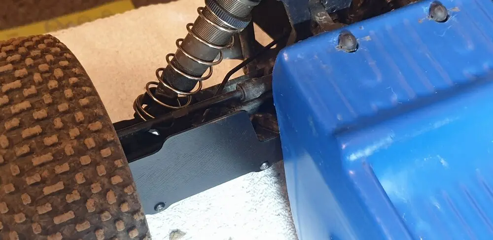

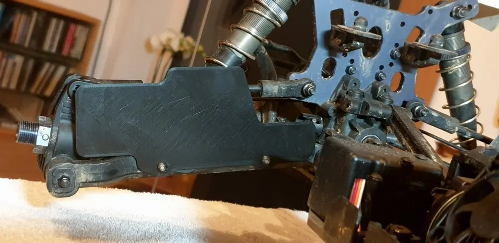

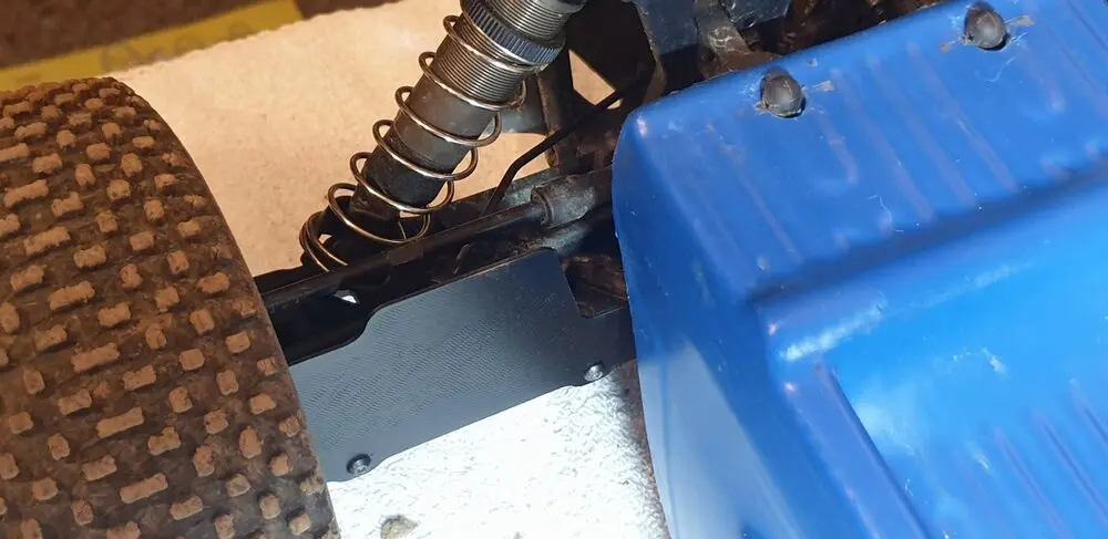

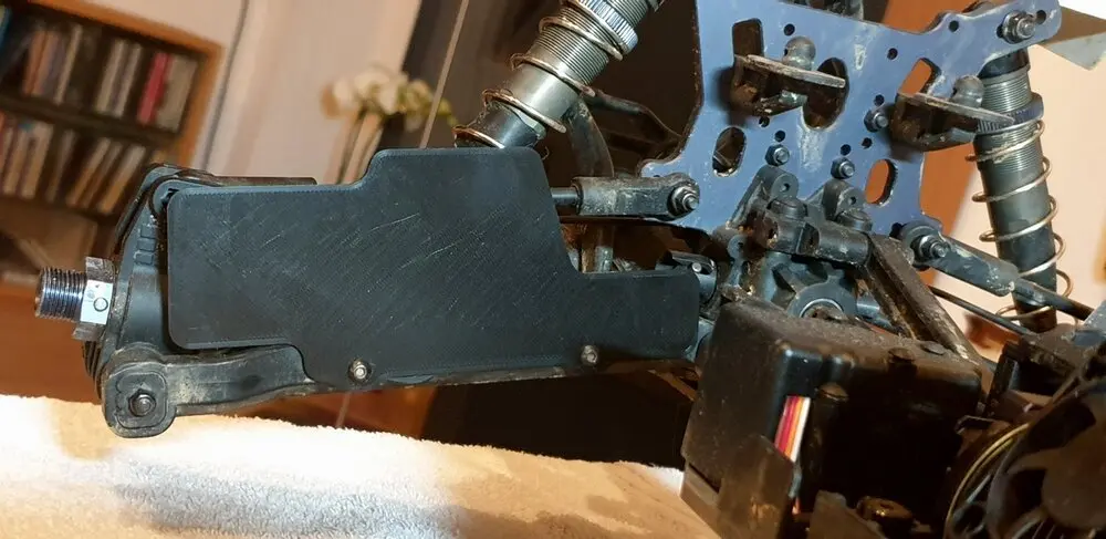

Those are the V5 of my Mud Guards for the ET48 2.0
They are thick at the bottom and 1mm at the top to be as light and as protective as possible.
It protects the bearings and shocks
Use the first layer facing the front of the car (the face printed on the glass, is smoother, dirt stick less)
Screws: 2 X M3 x 6mm button head per side.
Please like if you like it !
Download here: https://www.thingiverse.com/thing:5015442
